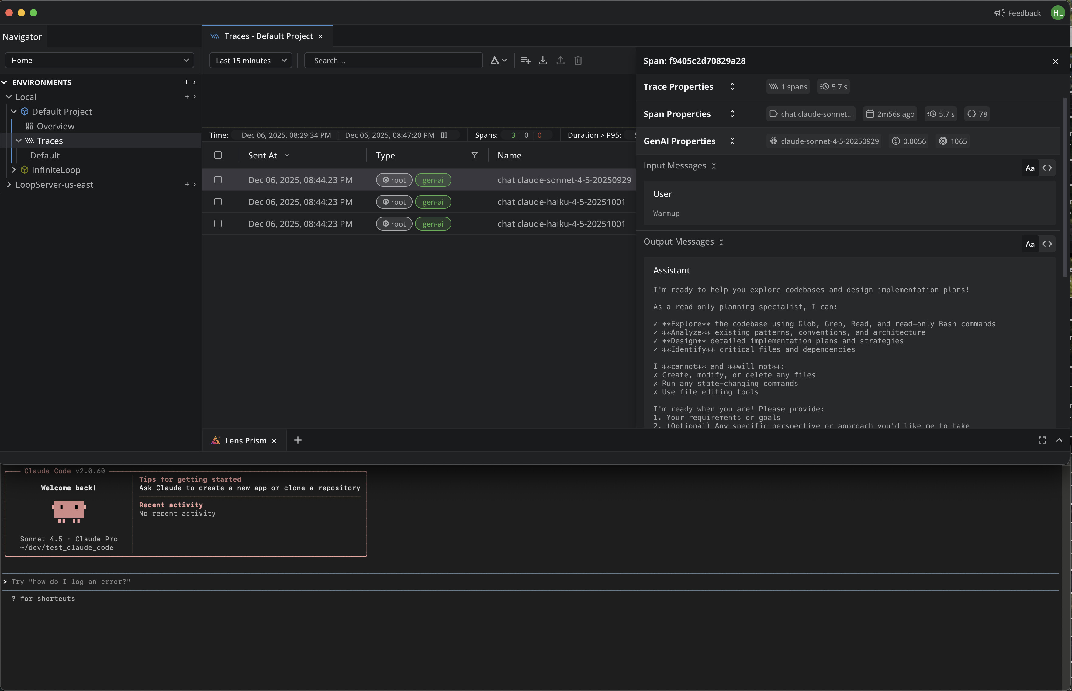

### 3) How to verify traffic / where traces show up
Once configured, run a few Claude Code commands and check Lens Loop.
- Because `x-loop-project` isn’t set in Claude Code request headers, traces will show up automatically under the **Default project** in Lens Loop.
- Please refer to the screenshot I attached — that’s the expected location.
 ![Screenshot 2025-12-06 at 20.47.21](https://forums.k8slens.dev/original/2X/4/4c15dd49eab27f7dd6ea0849d1f3348fa0fdb447.jpeg)
**Important note:**
We’ve identified a bug in our Anthropic proxying code, so the **current released beta doesn’t capture Anthropic traces correctly**. The fix is already done and will be delivered via **automatic update** in the **next beta release**.

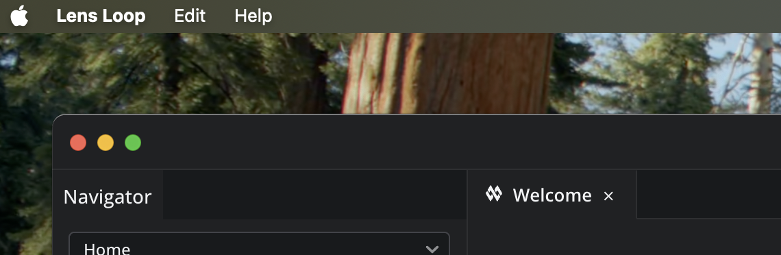

To make sure you’re on the latest version, you can manually trigger the update check on
**Lens Loop → Check for Updates…**
On macOS, this option is located in the app menu, as shown in your screenshot:
 ![Screenshot 2025-12-08 at 15.30.40](https://forums.k8slens.dev/original/2X/8/8046caa0703eb7214b654d15532b83337b68a624.png)
Once updated, Anthropic proxying and tracing should work as expected.
