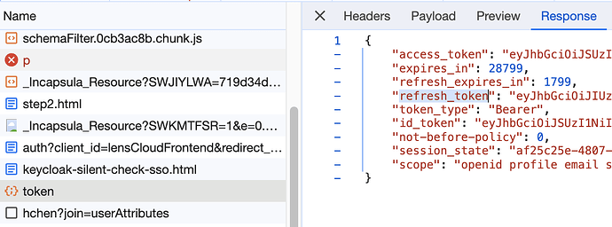

It says “expires_in” is 8hours and “refresh_expires_in” 30min so… the refresh token expires quite a bit sooner? Odd.
In any case, can you send us an example of calling the token refresh API please?
Answered my own question by digging in with the dev console:
  'https://keycloak.k8slens.dev/auth/realms/lensCloud/protocol/openid-connect/token' \
  -H 'accept: */*' \
  -H 'Content-Type: application/x-www-form-urlencoded' \
  -d 'grant_type=refresh_token&refresh_token=REDACTED&client_id=lensCloudFrontend' | jq
The above call will return a new refresh-token and access-token.
