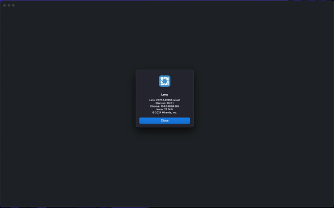

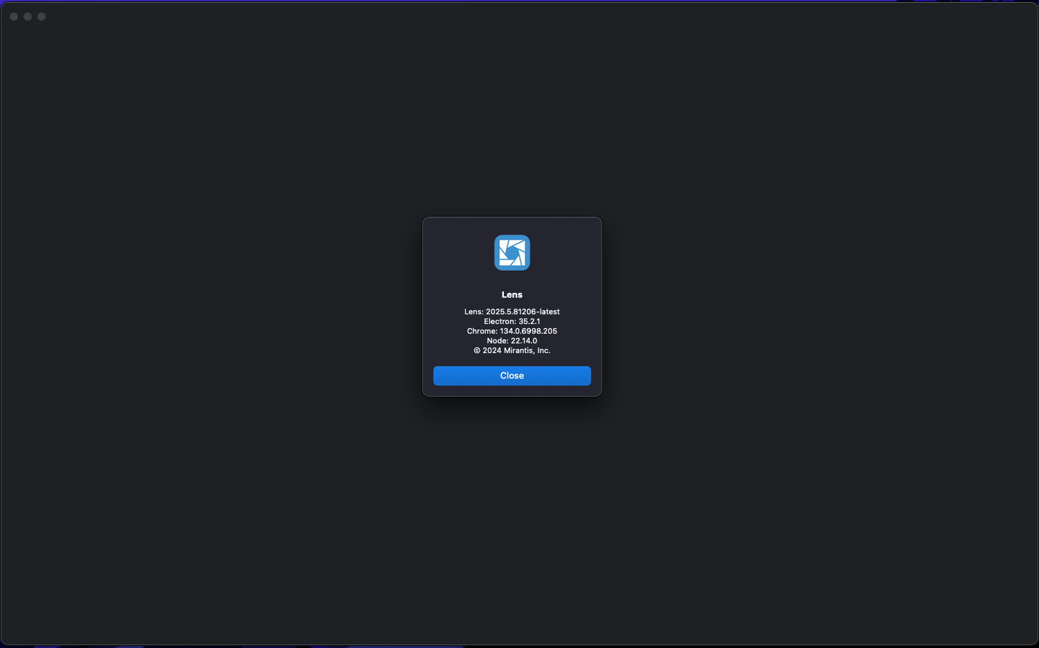

Lens isn't opening
Hello. What’s the problem?
Hi @maxpain177,
Thanks a lot for reaching out and sharing the screenshot — we’re happy to help get Lens working for you again.
