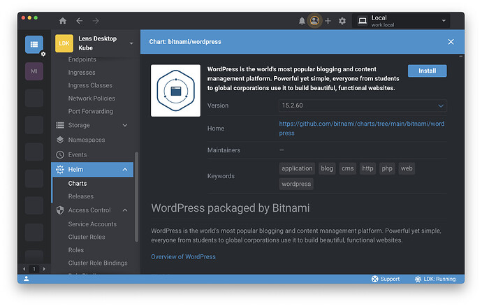

Click Releases under Helm in the left-hand navigation menu.

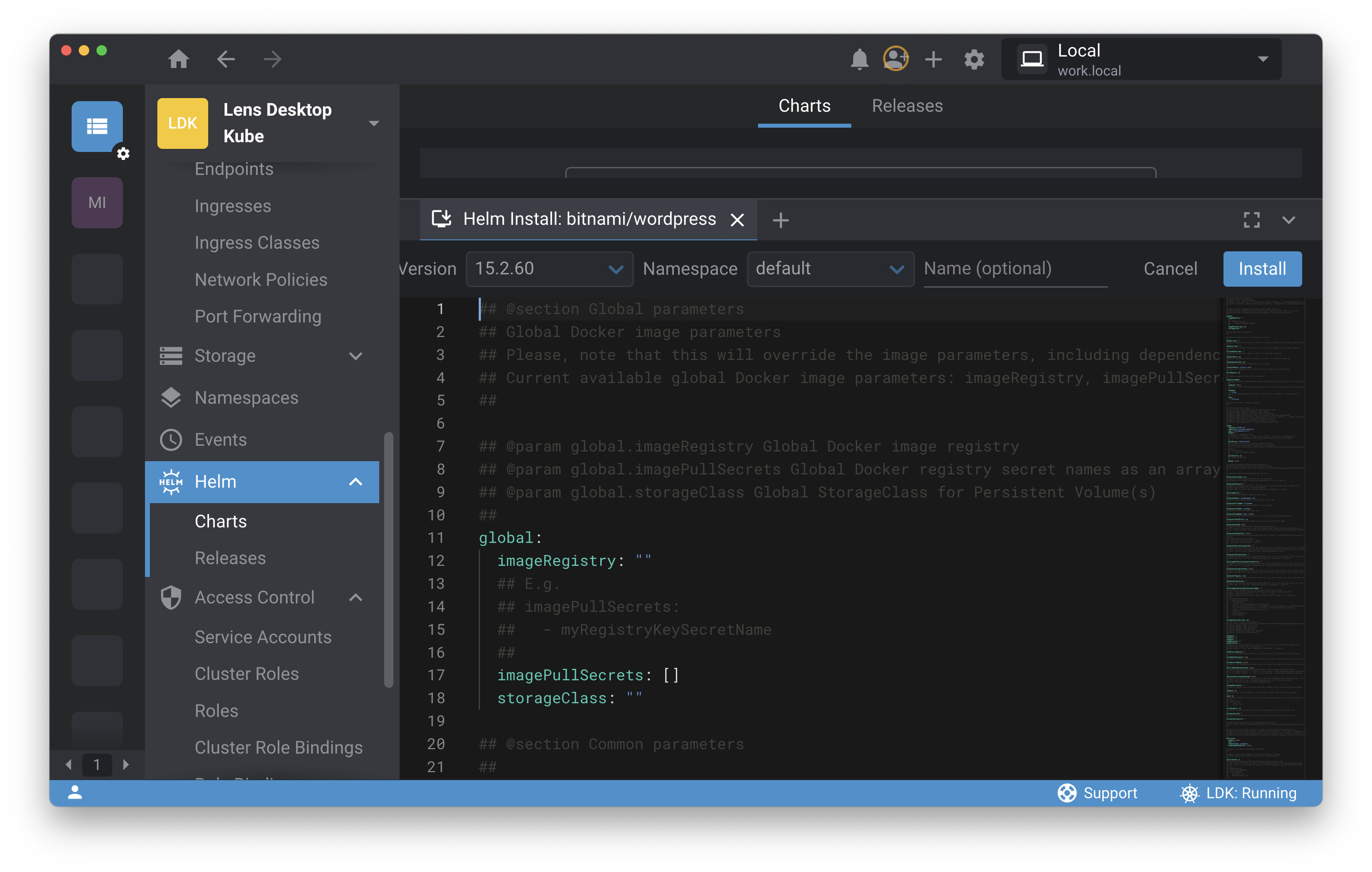

Select the WordPress chart from the bitnami repository and click Install , using the default values in the manifest and clicking Install again.

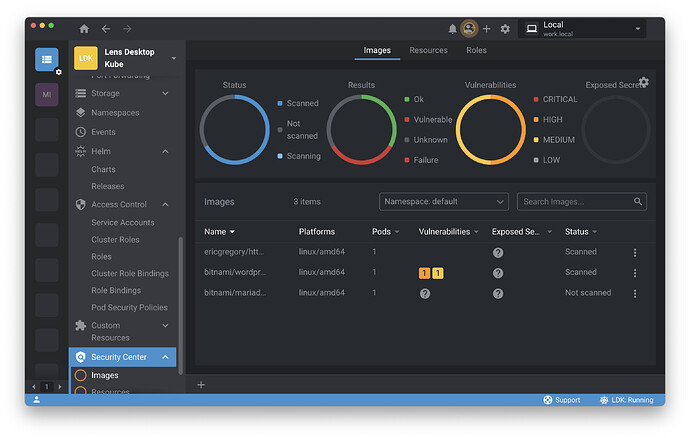

From the Images screen, you can see the images on the cluster and data from your scans.

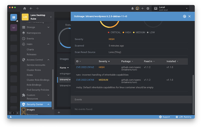

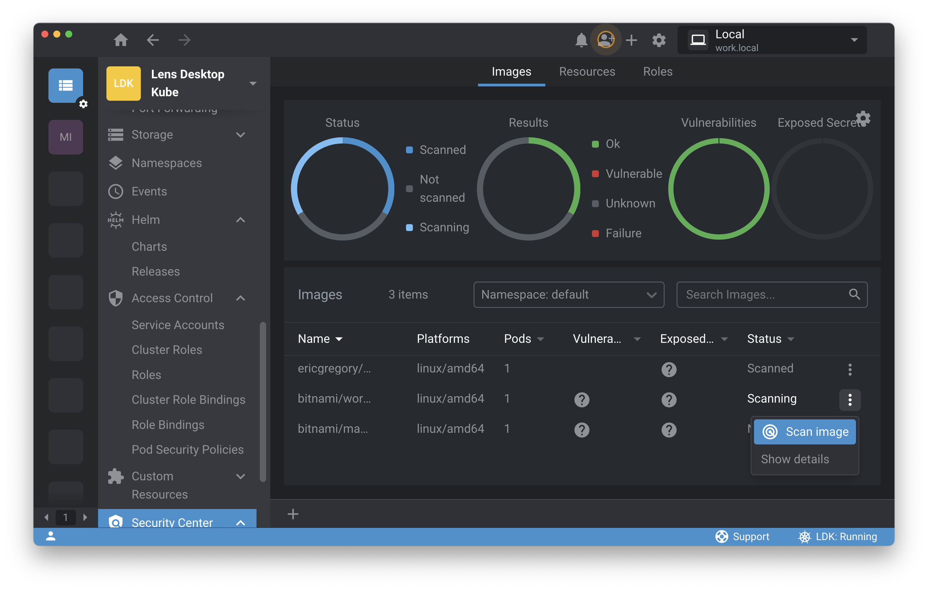

The http-server from Chapter 1 passed its scan—excellent. Now you’ll scan the WordPress image. Click the ⋮ icon and select Scan .
Lens Security Center found two vulnerabilities in the WordPress image—one medium severity, and one high-severity. We can click on the image for detailed information on the vulnerabilities:
From here, we can follow links to the relevant CVE records. We also have references for the version of the runc component in which the issues are fixed.

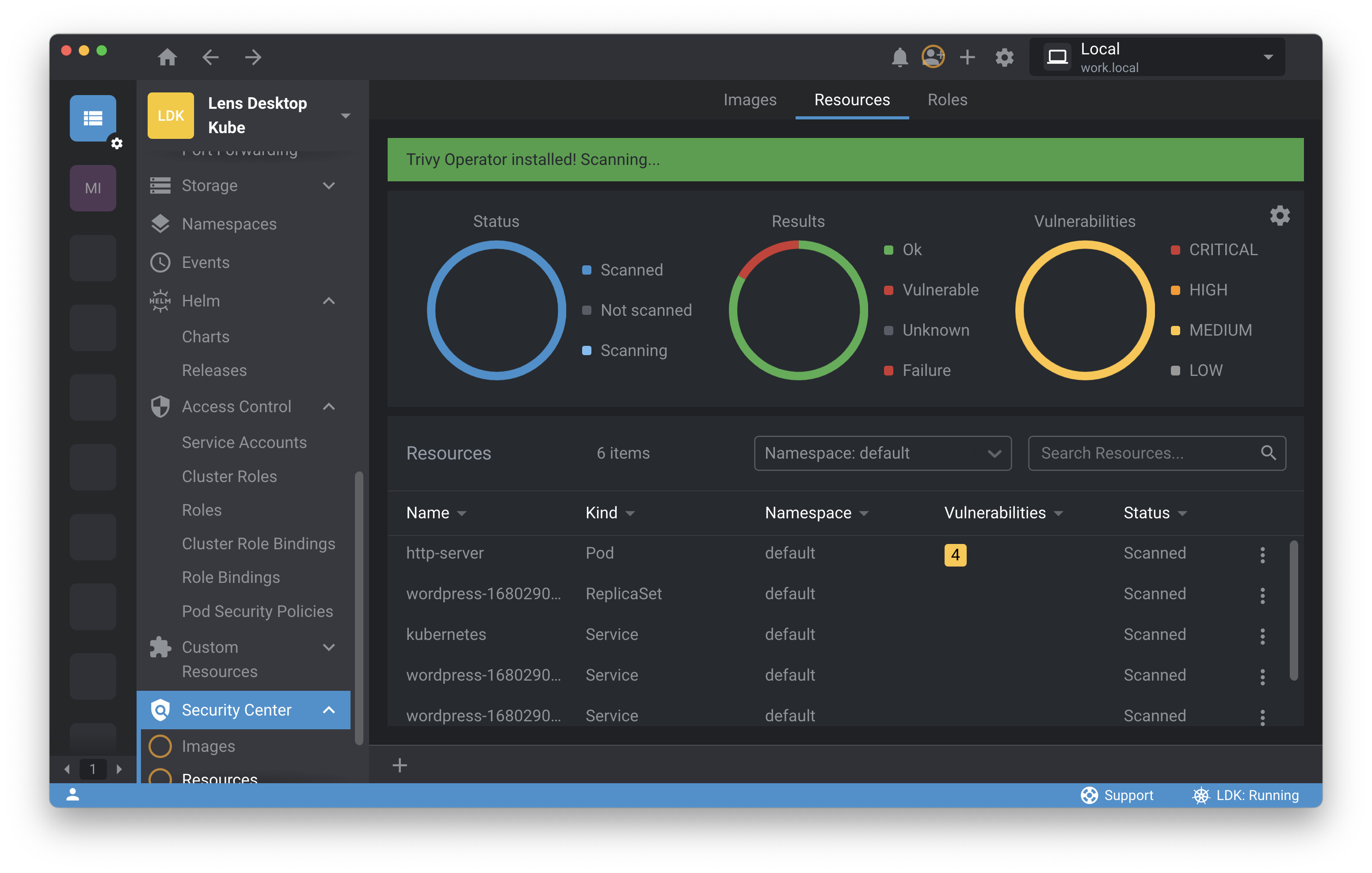

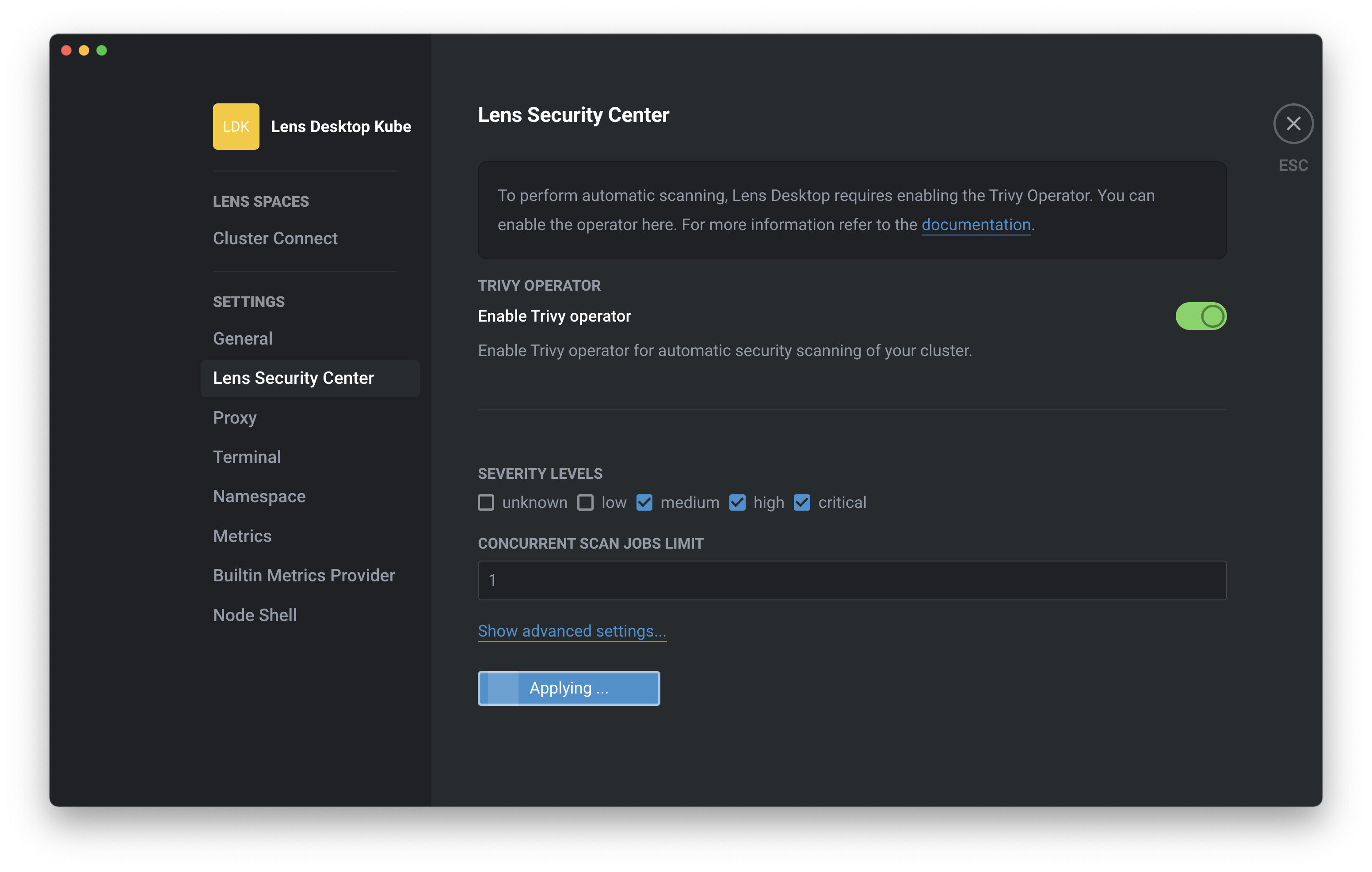

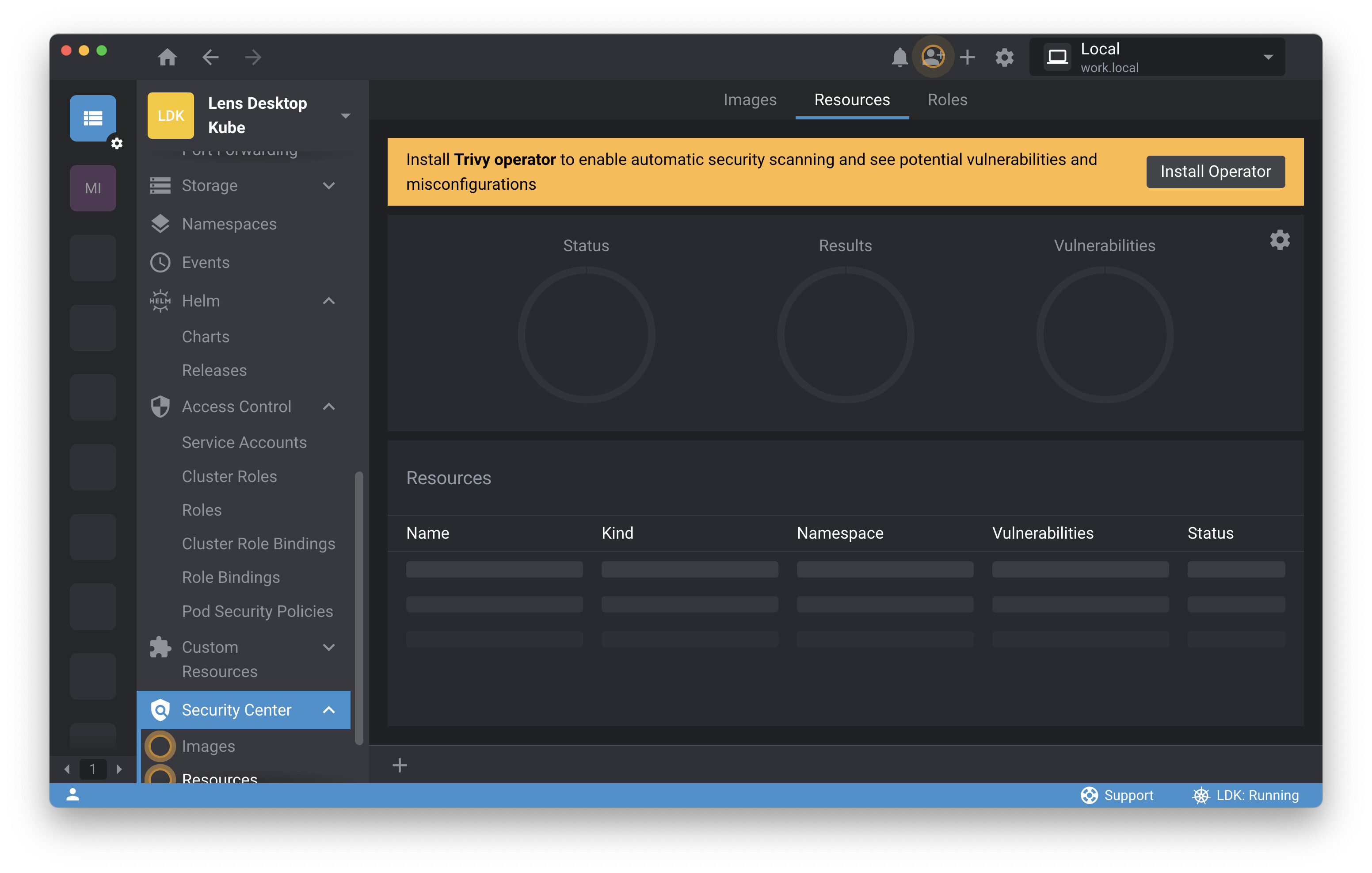

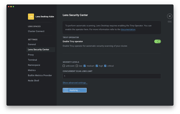

In the left-hand navigation, under Security Center , click Resources . You will be prompted to install the Trivy operator on the cluster.
Once the operator is installed, Lens will give you a readout of resource configuration issues.

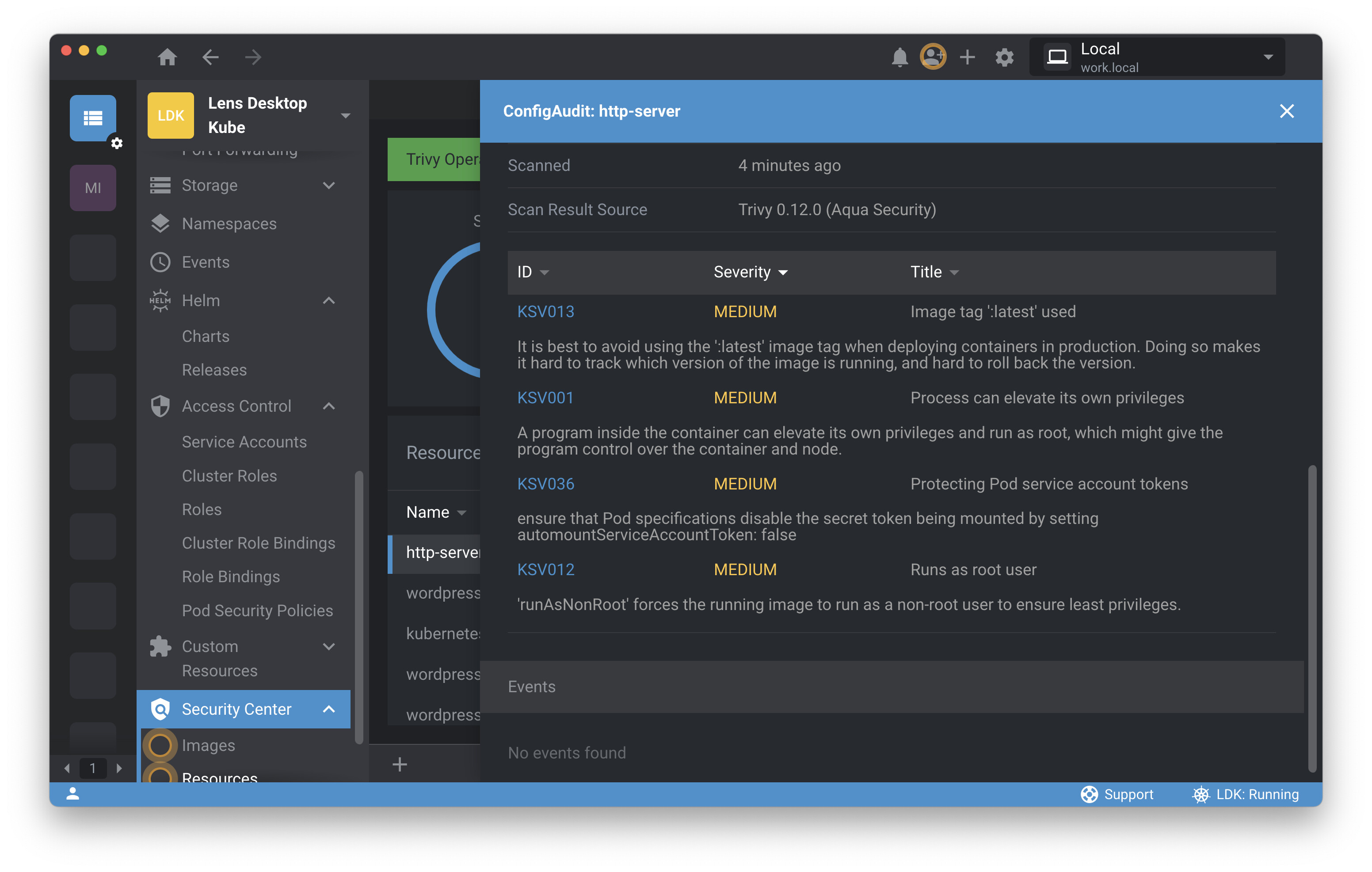

In this case, WordPress is looking good, but there are some medium-severity resource configuration issues on your http-server pod. Click on the http-server pod to get a detailed audit of the configuration issues.
The image is using the :latest tag, which is not a best practice, and more importantly it’s running as root, making it easy for the program to elevate its own privileges. This is an important issue to fix.

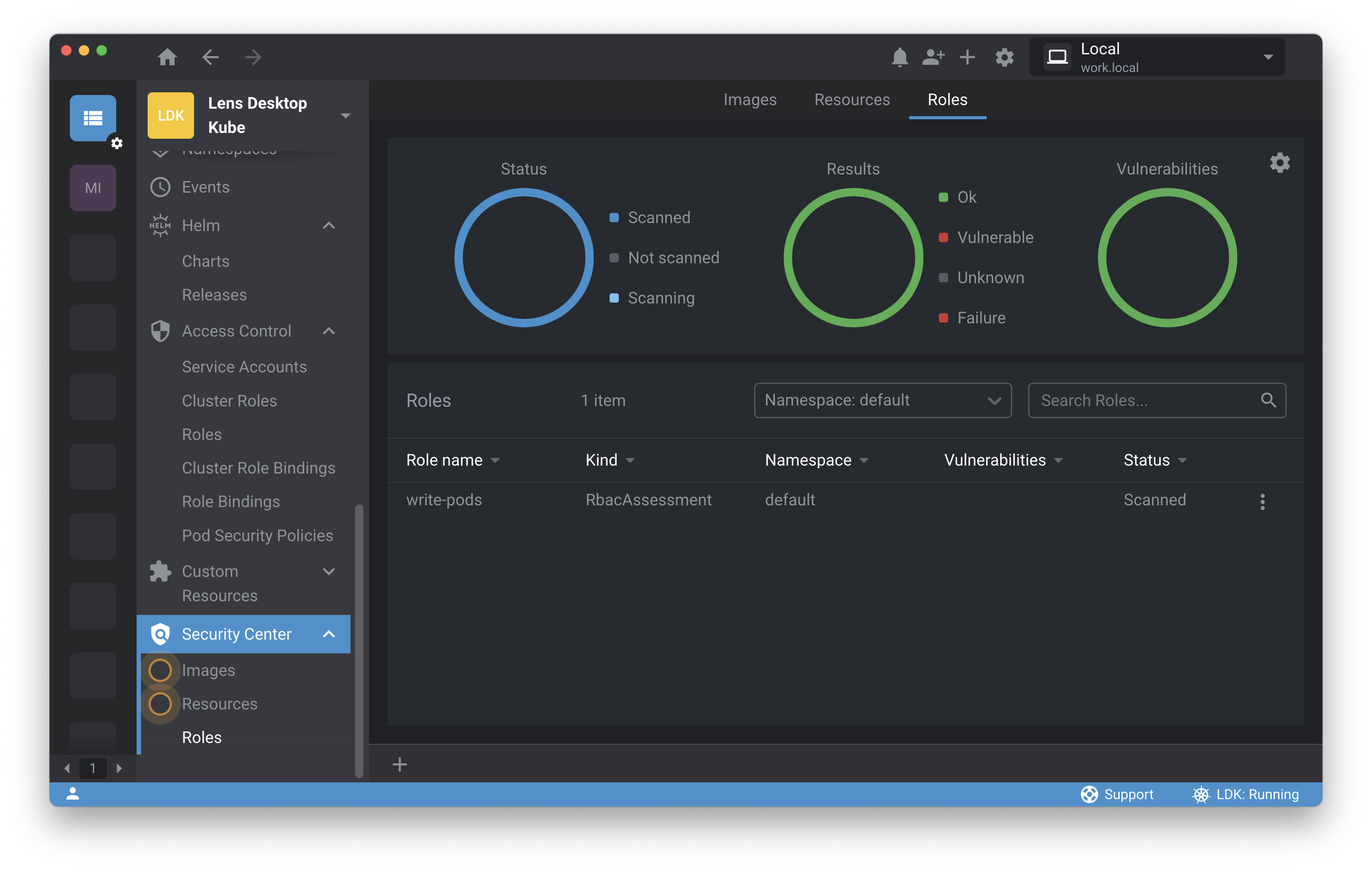

Finally, click on the Roles pane. Here you can see that the Trivy operator has already completed its scan, and the write-pods Role that you created earlier has passed the check.
