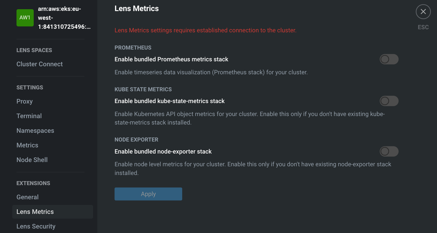

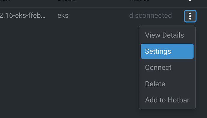

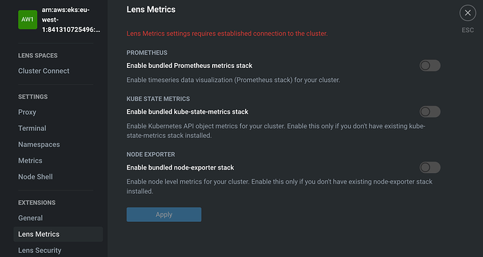

Hi! Metrics-server allows to fetch metrics for the current moment but it does not provide any historical data. That’s why Lens is relying on Prometheus to display metrics for the last 1 hour. If you want to try Prometheus out you can enable built-in Prometheus on cluster settings.
For example, in cluster settings
You can try to enable bundled Prometheus

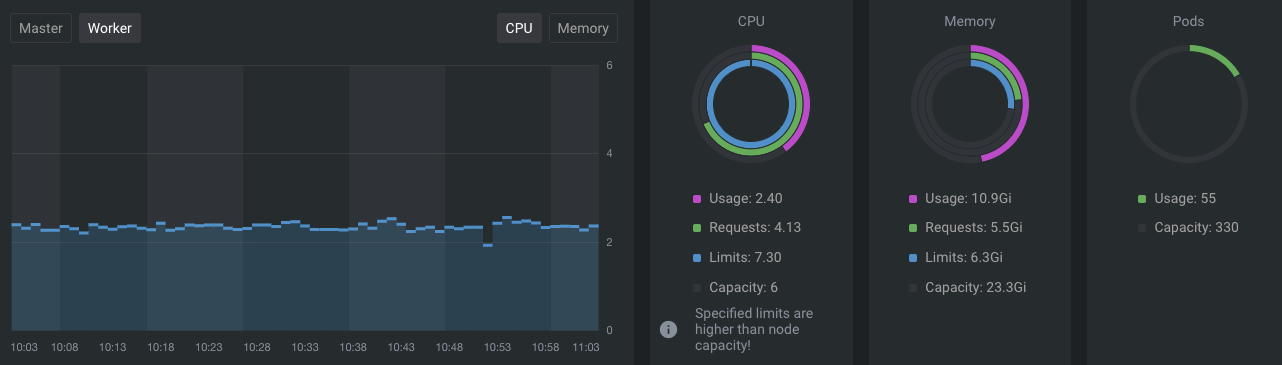

Still, to show by default as a fallback at least what the metrics-server can provides could be better than nothing.
As can be seen in the right part of the image below, some “current moment” metrics are shown in Lens.
