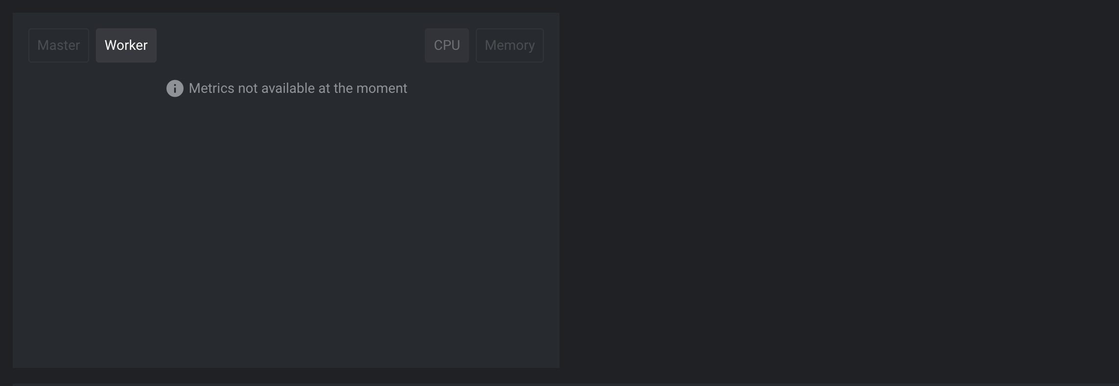

After updating the new version of Lens, the cluster metric displacement disappeared
After updating the new version of Lens, the cluster metric displacement disappeared.
Metrics not available at the moment.

After updating the new version, the cluster metric display was missing.

The prometheus-server is installed in a cluster. I tried to ask it with my hands in the settings, the result is the same. Metrics are displayed in grafana. When connected to prometheus, data is also visible. A colleague on the old version of Lens has no problem.
I compiled version 6.2.6 all metrics are displayed.
