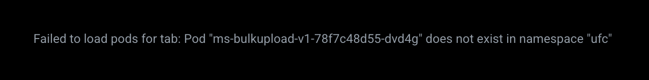

Sometimes i cannot get to load logs of pod. It returns that error. But the pod exists

I want to show the logs of a pod. Sometimes, I cannot show the logs and get the error in the attached screenshot.

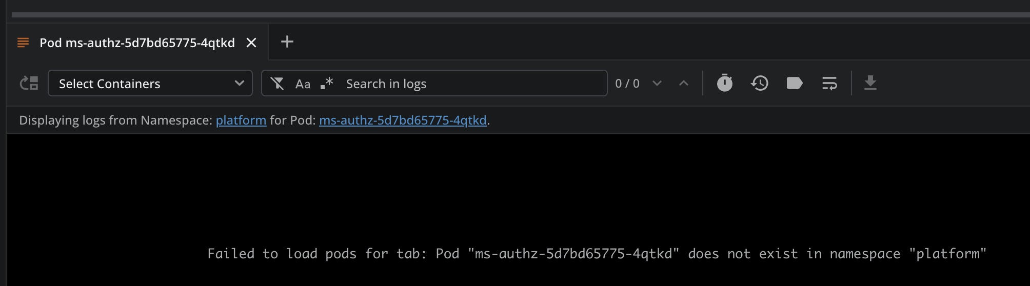

Hi @tkudinov, i’ve the same described problem like @realhuseyn .
I’m using following version:
Lens: 2025.10.230725-latest
Electron: 38.2.2
Chrome: 140.0.7339.133
Node: 22.19.0
on a Mac M1
I have this error since a few weeks, maybe 2 months ? Sometimes if a new pod is created while lens is already running, i click on “log” of the pod and the message appears:
Failed to load pods for tab: Pod “my-app-67d7d67f77-8qchm” does not exist in namespace “mynamespace”
To resolve this i have to disconnect from the cluster, reconnect again and there the log appears directly, without doing anything else.
It seems, that the list of pods in namespace is cached and not updated, when a new pod is created WHILE Lens is running.
This never happens to existing pods when lens ist started.
