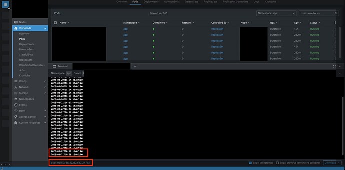

Hello,
When looking at a certain pod logs, and enabling timestamps, I can see that it matches current day and time.
However when I look at the bottom of the screen, there’s a message saying
Logs from XX/XX/XXXX ...
There the time and date is 3 days ago.
Any idea why is there a difference between the 2 values?
I tried reloading Lens, and it did not fix the issue
Logs from at the bottom takes timestamp value from first loaded log line. It basically means at what time do the logs start in this window.
Please scroll up your logs and note what timestamp your have on the very first line. If it differs from 3/19/2023 then it is probably a bug.
Yes, that makes match more sense.
I indeed see the first log is from the 3/19/2023
