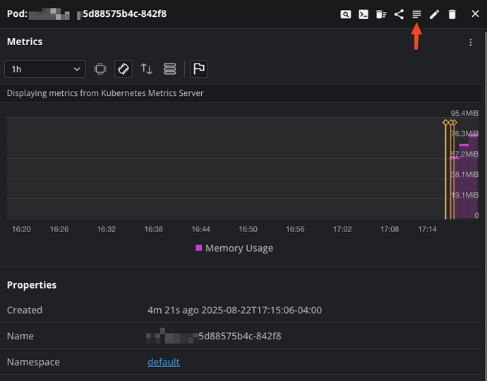

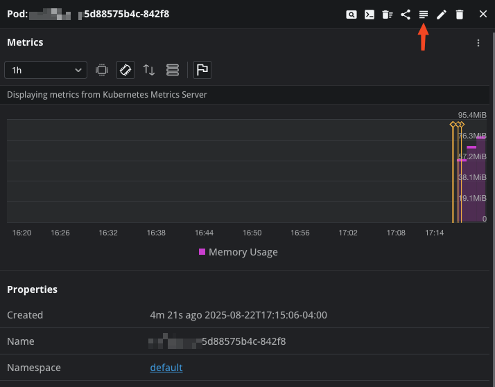

New issue, the Logs can’t load the pod logs anymore..
Failed to load pods for tab: Pod “xxx-xx-xxx-5d88575b4c-842f8” does not exist in namespace “default”
